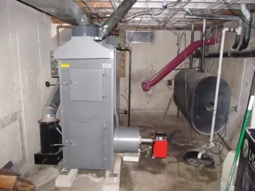

This is what I did. [Hearth.com] Who uses a wood chute?
