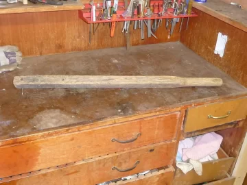

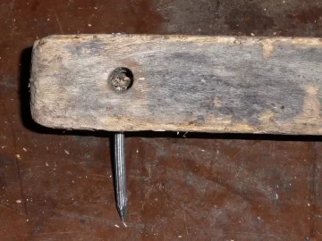

I love to make my own tools, the simpler and cheaper, the better. While unloading and splitting the most recent load, I found myself longing for a pickaroon/hookaroon to reduce the need to climb up into the truck bed. I wandered around in the garage until I came up the the necessary components.
The first was an old, very weathered handle from who-knows-what.
The second was a 3 in. long THS Fluted Masonry Nail.
I chose the masonry nail because they are hardened to Rc 45-50, making them hard, tough and bend resistant. (mild steel bar is Rc 20, a file is Rc 64)
I drilled a small hole through the handle to prevent splitting and drove the nail through. It does the job just as I would like and the nail shows no sign of bending (it was curved when I put it in), Total investment? Ten cents maybe. I may put a plate behing the head of the nail, it has pushed back a little.

Excellent idea. Fender washer w/ 3/16 hole would extend the life quite a bit.
The KISS is usually the best approach. I like it!
Now that I look at it some more,I'd guess that was a handle for a wheelbarrow.Judging by the square cross section over most its length & short round end
Reactions: MasterMech
I'd carry that in a dark alley. Maybe epoxy the nail in?

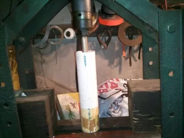

Firewood measuring stick, not my idea, but it fits this category. Made with 1/2 in. pvc pipe with holes at the desired distance from the dumb end and filled with powdered chalk. Hold the dumb end (I plugged mine internally because I was short of caps) at the end of the log or previous mark and rock it down so it taps on the log. Nice blue (or red) mark that is easy to see. The split collar is made from 3/4 pipe split lengthwise, it allows covering one or both holes (you need two for right or left hand marking).

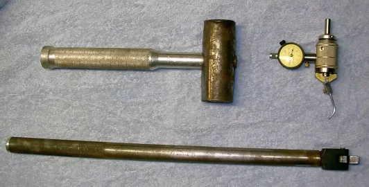

Here are some things I have made over the years. Sledge hammer, breaker bar, pallet breaker, coaxial indicator.[Hearth.com] Stupidly Simple Homemade Tools[Hearth.com] Stupidly Simple Homemade Tools
Not sure how many of those qualify as Stupidly Simple, the coax indicator definitely doesn't.:)

Few easy ideas for the nail.
Drill the hole all the way thru, :
Install a bolt. Nail won't move & if need, easy to replace it.
or cut the head off the bolt, hacksaw a screw driver slot, thread the bolt in.
or pound in wooden dowel rod

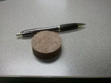

Hmmm...simple? Don't think so. Everything I build seems to have quite a few moving parts. Oh, wait a min. How about making your own firestarters (or shop press for that matter):

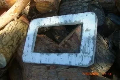

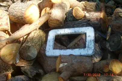

Used 3/4" subfloor with a hole in it tells me if the peices I split will fit into my stove door. If their length is shorter than that of the wood, it will not stick out the front. Painted white with left over latex paint so I can find it in the debri and to better weather proof it.

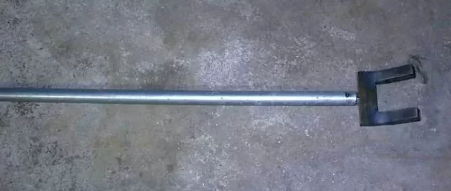

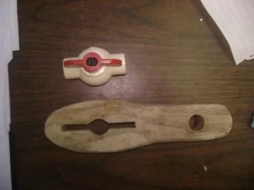

I made this wrench out of a piece of ash that I use at work. We turn a lot of CPVC ball valves and over time, rust and deposits bind them up a little. After cracking a few red handles off the valves with channel locks, I had to come up with a solution. It works really well and haven't had a handle crack since using it. The wrench has sat in the bottom of a wet bucket many times for days and has yet to split.
Reactions: ScotO and Realstone

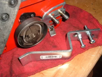

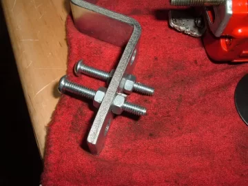

Simple tool to remove clutch from chainsaw. Found a bracket used to hold a 2x4 across a door, for security. Drilled two holes and inserted two bolts, spaced to match the clutch recesses. Metal handle is both long enough and offset so that you can get some leverage.
