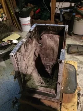

This is a 1987 Hearthstone II in black matte, I bought on Craigslist for $100.00 It was rough, every stone was cracked/broken, the whole inside was burnt up, and all gaskets/seals were gone.
The day I got it into my shop:
[Hearth.com] Hearthstone II rebuild
Teardown went fairly well, it was definitely over-fired.
