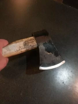

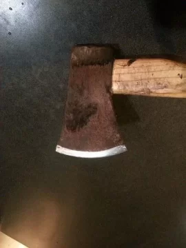

So i have this hatchet that I keep in a tub in my 4x4...I decided to give it some love this afternoon and after i sharpened it to the point where i could shave the hair off my arm i realized I needed to protect the edge. After a quick scrounge through the shed I found some thick ridged plastic (used for garden bed edging) chopped off a length and headed inside to start work on my first sheath....
The hatchet

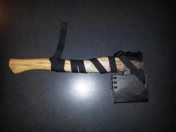

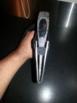

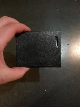

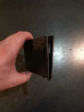

I heated up the plastic over the stove and folded it then ran it under cold water to hold the shape.....i then drilled out the slots....to finish off the slots i used a screw driver that i had heated over the stove to melt and form the shape....i did my best to chamfer the edge with a knife after it cooled...not knowing how the project would turn out I didn't spend too much time worrying about how good it looked..
[Hearth.com] DIY Hatchet sheath.  (first attempt)

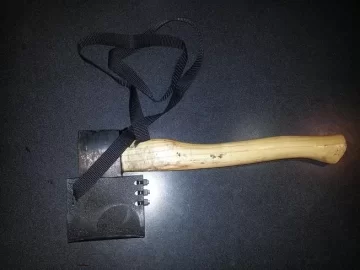

I then threaded though this strap that had a buckle used for tightening the sheath...I wasn't happy with how secure it was so I drilled 3 holes and used cable ties to stitch it tight.....i will eventually swap the cable ties for some paracord..
all wrapped up and secure....im stoked with the outcome...i feel confident in throwing it in a tub or in the back of the ute without destroying the fine edge!

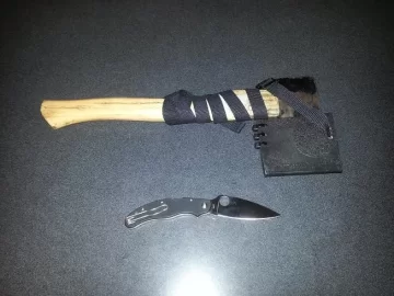

Finally a shot with my spyderco cali .....i love this knife!
