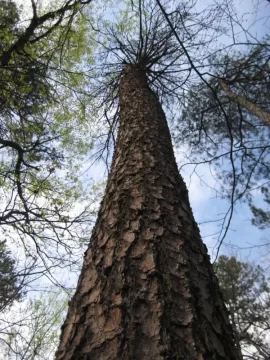

A few month ago I noticed a standing dead pine tree about 100 yards behind the house right along a trail I hike with our dogs every day. Since I finished working up that 32" diameter oak tree last week ( I got a bit over 2 cords from it) I decided to bring down the pine today and wrap up my logging for the season.
[Hearth.com] Brought down a dead pine tree this morning
It was about 75 feet tall and 16" in diameter. After I cut it and counted the growth rings I saw it was about 90 years old. Pine bark beetles got it.
