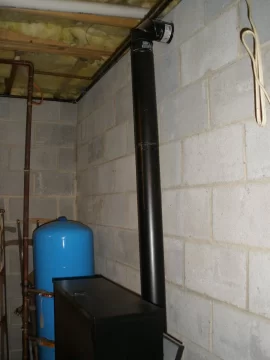

Coming out of the stove the exhaust is directly connected to a "T", the bottom cap being the clean-out. The vertical pipe goes 6' up the wall into a 90 degree elbow, then through the concrete wall to the exterior and extends approximately 4 feet from the house (to clear the bump out for our 1st floor LP fireplace). There is a 45 degree adjustable angle, with a guard to keep birds out. In addition to the complete stove cleaning today, I thoroughly cleaned the entire exhaust pipe from end to end with the brush. There are no restrictions.
Fresh air comes from the room it is located in (the basement). Nothing was changed in the basement from the date of install...July 2008.

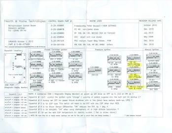

Harman0001.jpg I will check the solder joints and Scott, I hope I didn't jinx you. Went to the dealer (extremely helpful with some tips) and was given this attached sheet. I was told to check the ESP. I didn't get to shut down the stove like I planned as I needed to winterize my summer use equipment. Plan on the shut down tomorrow.
